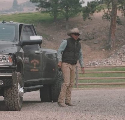

So folks can see the tires in question, here's a pic. They're every bit of 12.50 wide and I still believe they're 35" tall tire. They're considerably wider than stock and may be running a spacer in the rear so they don't touch. The tires stick out way beyond stock.

Never really looked at them from the front. Seems like the tire is bulging out at the sidewall because of how narrow the rim is.
