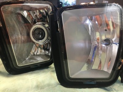

decided to rip the MH1 7.0s off the truck and try something different. Got some morimoto matchbox 2.0s and profile switchback halos and some cheap fogs off amazon to open up. Still rockin the hylux 45w ballasts and 5500k XB bulbs.
Took me 5hrs total including opening, retrofitting, wiring and installing. I think it turned out good. The switchback halos are frigin bright! I couldn’t get any good pics at night as the halos are so bright they glare my phone. Also the aftermarket fogs are fully chromed and a lot more reflective than the stocker and you can see it in the pic but they were $58 shipped for the pair with a harness and bulbs with prime.

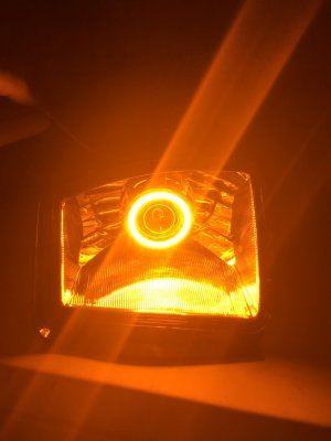

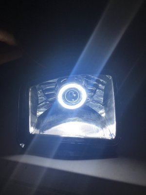

They are wired into the headlights so white as a DRL/running light and switch to amber on turn signal.

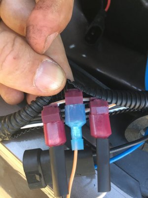

My install is on stock projector headlights.
These are my taps and connector. Orange wire from the switchbacks is the amber 12v which taps onto the stock wiring in the pic (middle).

Looks like turn signal is white and brown, running is white and orange stripe
