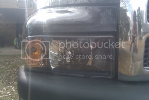

About 6 months later and I walk outside and see this on the passenger side
I just can't catch a break with this truck...

how long is their warranty? If its out..........pop 'em out, put them next to a dehumidifier, or AC vent - let 'em dry out. Seal around he bulbs, run a bead of silicone (black GE Silicone II) around the outside - that outta do the trick!

Mine do it too so you're not the only one.

I emailed them to see what kind, if any, warranty they offer. I checked all the emails and stuff I had for them but didn't notice any warranty info.

Warranty was for 3 months. Imagine that... But the company did say if I did re-seal them and had another problem, they'd sell me another set at their cost, which is better than nothing I guess.
I'll pull it out on my day off from work and see what I can't do with it

Where should I look for that particular silicone?

lowes, home depot, etc.
So, if you seal them back up and they still leak........they send you a set? thats weird.

The guy said that if I have another problem with them leaking after that, I could send my set to him, he'd look at them to make sure they're not physically damaged, and if they're not, I can buy another set from him for what he pays.
If I pull them out, re-seal them and they leak again, I'll just order a set of OEM's from work and send them to you lol
