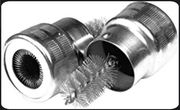

This all sounds somewhat logical but, our trucks are rolling microcomputers and when we have significant erratic behaviours on multiple systems, the most common root cause is the supply voltage from the battery or bad ground connections.
Have you confirmed the battery post connections are clean & snug?
I use one of these post/clamp cleaners about every 6 months and apply a very thin film of dielectric grease on the contact area of both the posts and clamps.
https://www.harborfreight.com/battery-terminal-cleaner-94450.html
Given the age of your truck, the issue is more likely to be a ground fault but, ground faults can be an enormous PITA to troubleshoot and or resolve, not always though.
