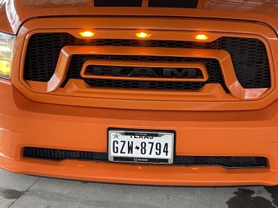

So I changed my stock grille to a Rebel style about a year ago and haven’t been able to find a lower bumper grille that I liked. My wife had bought me one of those cheap stainless slat grilles for it when I had my stock grille and that clashed with the honeycomb of the rebel style grille. Since I could find anything different for the sport bumper I decided to make my own. I started with the factory lower grille and cut out the center of it leaving just the edge. Then I took some plastic honeycomb I found online and cut it to a rough shape. After some time of trimming and fitting I used automotive panel adhesive on the back and taped it all together to dry. Overall I really like the way it turned out and it snapped back into the bumper like factory. Thought I’d share my results for anyone wanting to attempt the same.

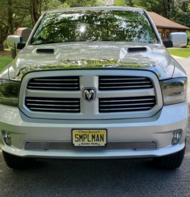

I agree...this is what I had when my truck still had its stock grille. My main complaint with this one was it didn’t match the width of the stock upper grille.
I like it. Its better than seeing that black plastic insert
