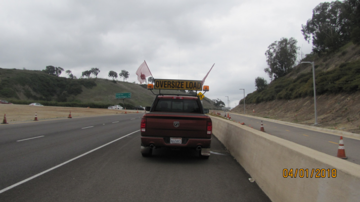

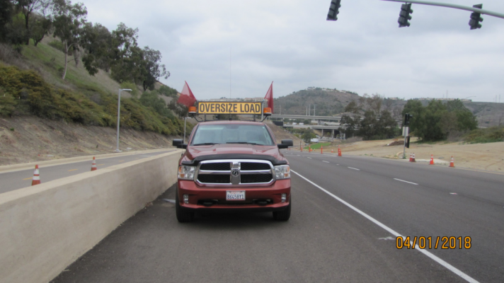

Just Waiting on a 8 lane Highway Ramp, no buildings nearby, truck driver may show up at any time.
When he passes by on the main Freeway, i have to fall in behind him.
Truck is Idling, for a quick maneuver
