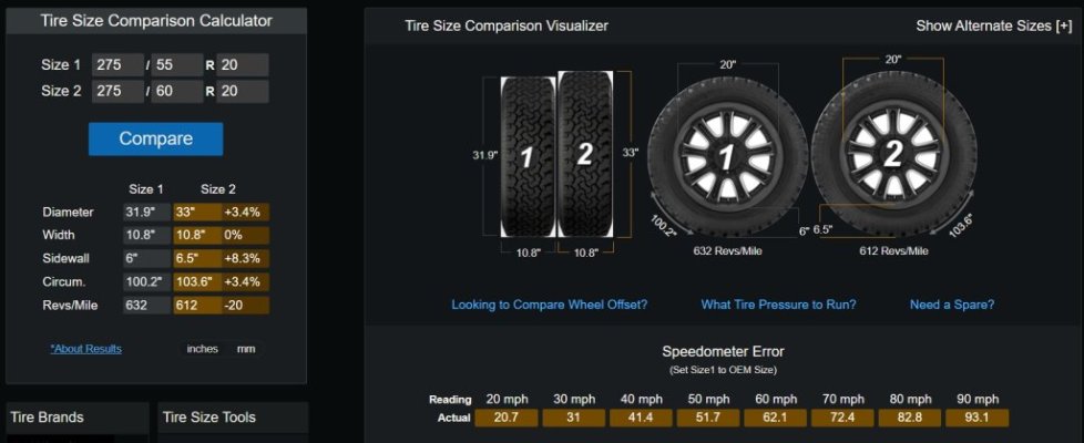

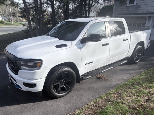

Hey all. After getting nearly ten years of great treatment from a 2016 Express 5.7, I just purchased this 2023 Big Horn 5.7 Night Edition. Now I am looking for suggestions and ideas on what I should do to it. Specific things like oh, the '23 5.7 needs oil changes every 5-7k, not 8-10k like suggested and only use the Mopar filter or change out the cabin filter every other oil change or make sure to do manual software upgrades regularly. Stuff like that. What general preventive maintenance should I be aware of and do? Paint protection, undercarriage coating, seat cover protection? What modifications are a good idea to improve the ride, transmission shifting, engine efficiency, etc.? Just the topics and I will research it here from there if you do not want to go into the full details.
My first change will be tires. I am not a fan of the Kumho A/T tires it came with and will be switching to Highway all season. Strongly leaning towards the Michelin Defender LTX M/S 2. Only question is stock 275/55-20 or go up to 275/60-20? I just like the 33" look. I know the speedo will be off 1 mph at 30mph and 2 mph at 60. I will get that recalibrated at the dealer.

Nice ride! First thing to finish enjoy the ride!
Highly recommend the tires you are thinking about, but going bigger is opposite another idea you had about engine efficiency.

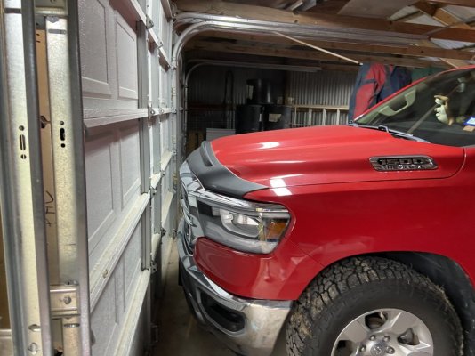

Your money whether you clean and protect yer ride or pay someone.
Undercoating depending upon where U R. If do Krown or Fluid Film coating.
Seat covers. Personal decision.
I have a Dash Cover and AVS II Bug Deflector.
U can go crazy separating money from yer wallet and forum members be happy to tell U how.
You can see my AVS II DEFLECTOR from side in photo. U can also see dash cover.
Good luck with new ride.
All above IMHO only.

There are a few options that will allow tweaking your tire sizes, and some apps can customize many other items.
Many of us use AlfaOBD to customize our rides.
Once you buy the required equipment, you're set for tweaking several FCA vehicles without any additional cost. No VIN lock.
Use the search utility in the upper-right corner to search AlfaOBD or any topic of interest.
This online wheel comparison calculator shows the difference in tire size and the speedo error.

Beauty of a rig!

I had the Michelin Defenders and got about 65K out of them. Rode and drove nice on highway and were good in Colorado snow. As far as recalibrating the speedo you may not need to do it. I have a 2020 with navigation. Apparently (read on the internet-and that's never wrong) the vehicle will auto calibrate the speedo to match the navigation's GPS over a few hundred miles when it determines a discrepancy with the miles and the GPS. I don't know if this works or not but it's worth a try. Get new tire and drive a few hundred miles and check it on an interstate with a stopwatch and 20 miles odometer. Good luck.
