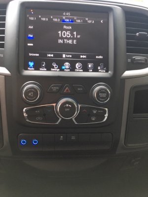

New radio upgrade complete
ramtaz64
Jan 22, 2018
93
21
Blackwood, NJ
Just wanted to send a big thank you to Mike (mpgrimm2) for the harnesses I needed and guidance and to Don for the radio and bezel.
Also want to thank Ricks Ram for pointing me in the proper direction on getting the correct info and contacts.
2015 Ram Express

How difficult and expensive is this upgrade? I would love to do this on my 2015 Express.

It is not that hard once you gather all of the parts required.. Price would depend on how much you can get the radio for.. this guy here can get you all of the wiring and misc pieces you need.. Mike - his name.. mpgrimm2 - his userid on forum.. send him a message....

I'm doing mine this weekend all the parts are in the garage and yep thanks to all here that have helped!

All in and done for about $475. It is an RA3, don't really need the nav or the car play so it was worth it.
