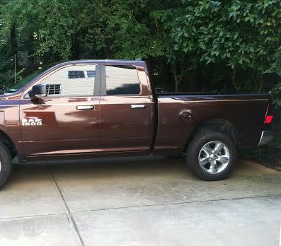

Hey guys i recently got my rough country level installed, and now im on the hunt for tires. Im ready to get rid of this sh*tty stock tires. I will be running stock wheels. So i was thinking 295/60/20's
I just wanted your guys thought's/opinion's on what looks best.
Here is my truck
Sorry for bad pics had to go to work

I would think 295/65/20 (35.09") or 305/55/20 (33.20") for shorter height but wide stance. I guess it depends on if you want to fill up the fenders or widen the stance, but still have some fender gap over the tires. IMO 35s do not look good on a leveled truck. Too stuffed in the fenderwells look, but to each his own.

That size comes out to a 34", and IMO 34's look great with a level. Gives the truck just the right wheel well space.
If you're asking about tread, really depends on where you drive you truck. I couldn't justify going with MT's because of the miles I was driving every day. I chose Nitto Terra Grapplers, was the most aggressive AT I could find at a decent price.

305/55/20's = 33.2 x 12
295/60/20 = 33.9 x 11.6
295/60/20 = 35.1 x 11.6
275/65/20 = 34 x 10.8

depending on what size you choose, and tire selection...
you may need a 1/4'' spacer depending how aggressive you side wall is.

What do you plan on doing with the truck? I like the 295-60-20 look with a level but as far as the tire that would depend on if it's always on the street and little dirt or you go muddy spots.

Its on the street some but i do take it off-road a good bit.
I like toyo mt, but they only have a 295/55/20
Would those look good to you guys?

I have the Cooper STT in a 35 12.50 20 and love them, smooth ride, a little roar going down the road but I like it

Check the actual toyo tires site they make the MT in a 295/60r20 as well as the toyo AT extreme version in that size. I don't want to post a link but just google Toyo tires and you look through the open country and you can get the MT and AT extreme tread.
