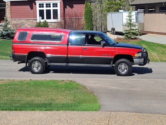

Picture from this summer. It has original factory paint and no lifts or engine modifications.
A few Hunting seasons ago.

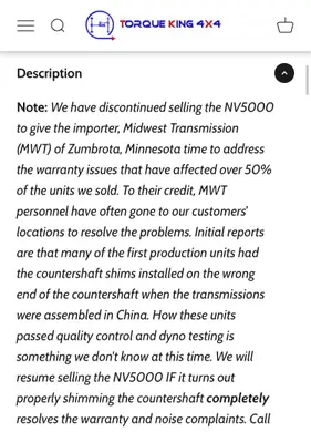

Now I found this, the NV5000, a redesigned NV4500. This would be good but while the HP rating is 500, the torque rating is only 500 lb-ft, and I'm sure I will be well over that with planned engine mods.
