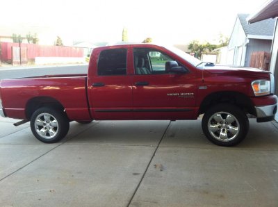

Hello Everyone. I am new to the forum and had a question. I recently bought a 2006 Dodge Ram 1500 4x4 5.7 Hemi and used the hells bent 2.5" leveling kit in the front and was wondering if I could fit 35/1250/20 tires on it? Also regarding the rim size. Would you recommend I use 20x9 or 20x10? Any help is appreciated.

Welcome to the forum! The tire experts should be here quick to answer but I'll give it a try. You would probably be fine with the 35's the main thing to be concerned with would be rubbing. I would think that either getting a neg offset or wheel spacers you would be fine. As far as 20x9's or 20x10's I'm not real sure on that one...

go for the 20x10 but make sure you get a negative offset but the 20x9 will work also....
key is right offset and backspacing for 35x12.50 size tires...
you wil be fine height wise its rubbing on the UAC that gets us on these trucks

Like GhostRam94 says. Make sure you get negative offset on the wheels.
