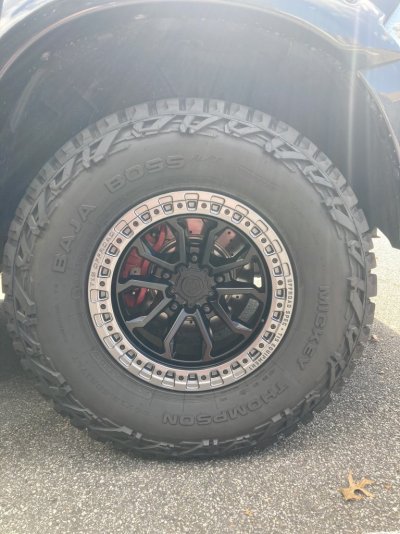

My original setup, leveled with 18’s and 35”, had a slight rub on uca’s full lock in reverse.
I didn’t have the right offset/back spacing, ended up getting wheel spacers to fix.
Current setup 17’s and 35’s with the right offset for my truck anyway, no need for the spacers.
I have been very happy with my Mickey Thompson tires so far, the Nittos weren’t bad but seemed to loose traction after about 25k

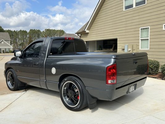

According to LouM, I guess mine's "amazing" then? lol
Raised looks good, but ain't nutt'n sexier than a lowered RCSB imo either.
These are 22" btw.
These are 22" btw.
I'm glad that you like your truck.
I don't see the desire for such a vehicle, while I can appreciate the work that went into it I have no desire to own or even ride in such a vehicle.
I also don't see the desire for the monster truck lifts and tractor tires on a street driven truck.
A truck on low profile tires is a paradox, low profile tires aid in traction and handling on super smooth paved surfaces. Not many of those around.
lol, you and my wife share the same sentiment, she hates my truck because it's no longer a real truck.
