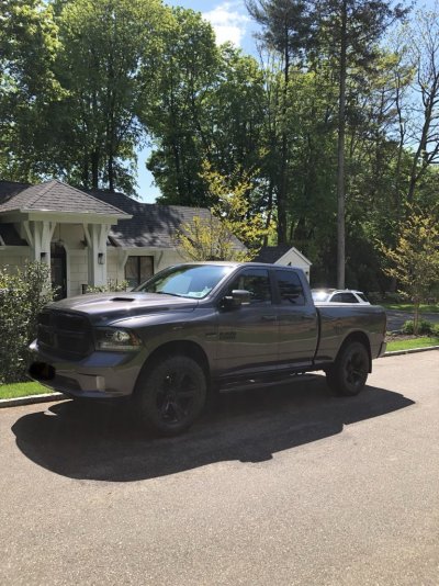

I have the same setup on my 2017 no spacers no issues!
