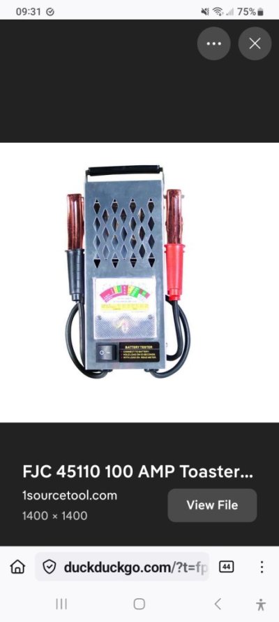

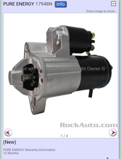

Fwiw, mine did the same thing at a similar mileage (198K). Tapped it with a hammer, and it was good for quite a while.
I bought a Pure Energy starter from RockAuto, was ~$100.
I procrastinated on changing it and it did it again at about 203k miles. Tapped it, and it started, but I went ahead and changed it since I already had the new starter for several months.
