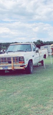

Hey y’all I just received this from a family member and would like some info about it if y’all can tell from the photo. Mainly the stock wheel and tire specs so I can get it home. I’m a Toyota guy and new to the dodge scene so please no hate lol. It’s an ‘851C8083DF-7203-4D5D-AE37-5EA29BAF044C.jpeg

1985 1/2T wheel specs:
OEM Wheel Size(s): 15 X 7
Bolt Pattern: 5 X 5.5
Stud Size: 1/2-RH
Hub Center Bore: 77.8
Torque Sequence: 1, 3, 5, 2, 4
75 to 85 lb-ft.
