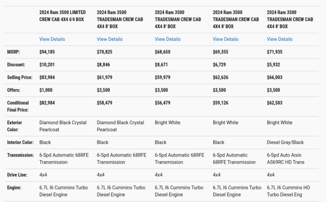

What are some things to look out for with the 2023, 2024, and 2025 models of Ram 3500s? The picture below shows 2 different types of transmissions, and I don't know enough about cars, let alone diesels, to know what I'm looking at. My family has a Gooseneck Horse Trailer, 5 or 6 slant stall. I have access to a Gooseneck Flatbed Trailer that everyone takes turns pulling to do an alfalfa/hay run. That's not the exact trailer, but it gives you a close enough idea.

The Aisin transmission is the heavier duty of the two transmissions as it is part of the High Output version of the Cummins. The "regular" Cummins has 370 Hp and 850 lb-ft of torque where the "High-Output" Cummins has 420 Hp and 1075 lb-ft of torque. The regular version is a $10K option and the high output version is another nearly $3K on top of that.

If the trailer(s) you'll be pulling will be about 18,000 lbs or more that's in 3500 dually area. As for the transmission the Aisin is usually preferred by people who haul heavy, which is available on the HO Cummins trucks.
Depending on how soon you need a new truck, there's a good probably that there will be an 8 speed transmission for Cummins trucks for the 2025 model year.
