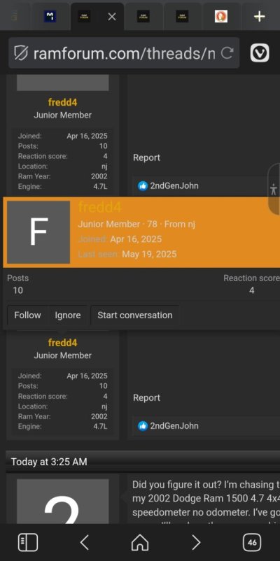

The OP hasn't been seen since 09 '2024 and fredd4 since 05 '2025.
