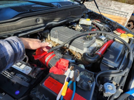

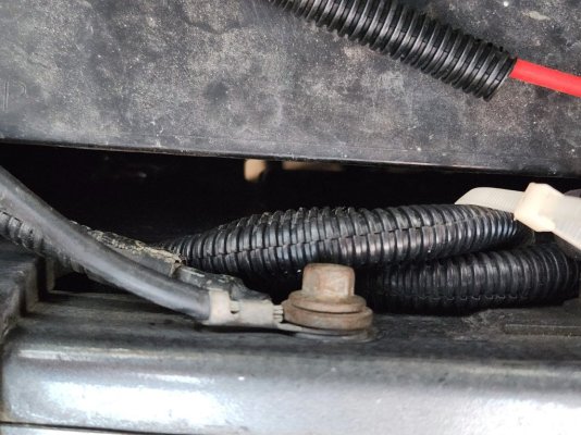

I'm starting with the passenger side / FRIED battery , terminals don't look toooooo bad , and yes I use RED GREASE on my terminals. No oxygen, NO moisture, No acid = No corrosion (ALMOST) Continuity check passes battery ground, small ground cable to fenderwell , and the ground going down to what ever down there ..... wait NO CONTIUITY ??? could be rust on this end of cable........cleaned off rust ....still no continuity..... followed that ground under my truck ...... It's the lead from my Negative post to my TRAILER/ REAR Jumper cable power. I'll follow it to the rear, just to see if the positive and it have rubbed raw and are arcing together(Longshot at best ) Damn I don't remember 40 degree's being this cold20260227_064439.jpg

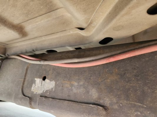

Well I followed it to the end , no rubbing , false alarm

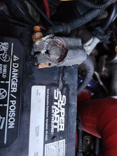

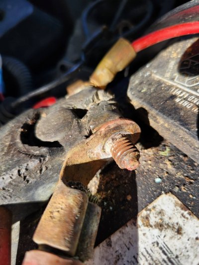

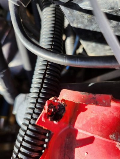

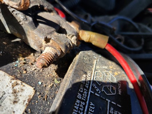

I agree you Seafish, I'm just slower than I used to be, so moving on to the Crossover Cable , I then went over to the Driver battery, to look at the cable end that burnt that cover , as you can see below, a little crummy, BUT , I bet it's about the same as half of you guys's cables.
So the reason I went over to this battery is so that I could do this .........Check the continuity from the Bad Battery POst to the end that tied to the Driver Battery .......
And Remember that sucker is still live , so wrap it up 90% to eliminate the chances of a little light show.
( I decided to keep it attached and chance it so I was 100% sure of what I was measuring )
And the results: (crossover cable means the end I just detached from the Driver Battery)
Crossover Cable bare end to Dead Battery Post Continuity ....... YES
Crossover cable end to OTHER side of Crossover cable continuity .........YES
Crossover Cable Bare end to Dead Battery cable end (when still attached) OHM's .......... 00.1 to 00.2
Crossover cable Bare end to Dead Battery POST (still attched) OHM's ......................... 00.1 to 00.2
HUH ?? ..................................
Well so far I'm coming with all cables looking pretty good, a little corrosion but not exceptionally bad , and no bad cables YET !!
Stay tuned still more testing to come....................

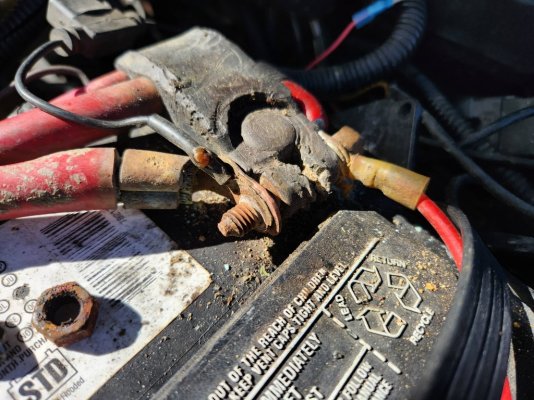

So after all the test's above coming back ACCEPTABLE, I am starting to lean to that rarest of animals, the battery came to it's END OF LIFE ! Where the sulfate (or whatever) on the plates finally flakes off enough to bridge the gaps at the bottoms of each plate , causing an internal short circuit thus leading to thermal runaway and we have a "MINI CHERNOBLYL" Battery Meltdown ...........
BUT I still have a couple more tests .............
Remember the Battery is 5 1/2 years old , never given me an once of trouble , and when I restarted the truck at home, and ran it for 2 minutes , hooked up my scanner and It came back with NO CODES !!!

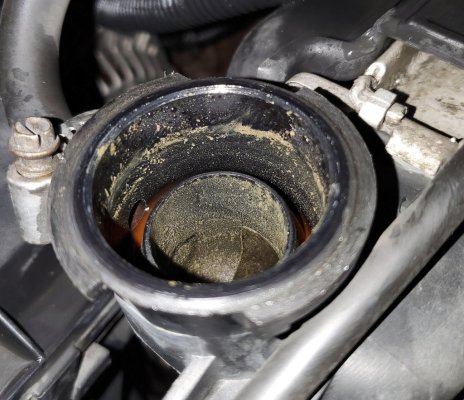

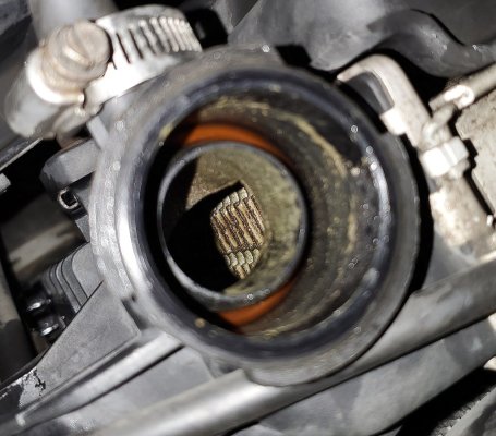

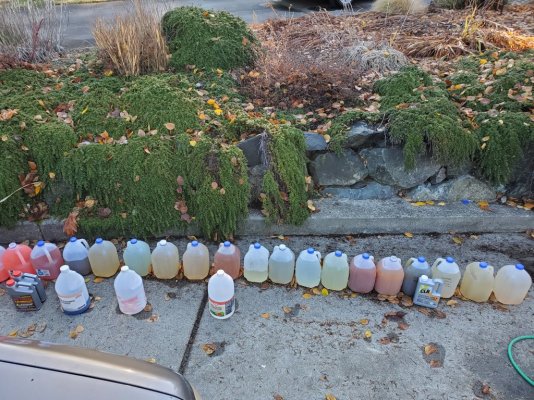

ME ..............Ya , I learned long ago about using Distilled Water, but some still throw tap water in. Heck, even in an EMEGENCY you can still find a Distilled Bottled Water at 7-11 , just have to read about a thousand labels of all the different types of water they sell, but eventually you will find a spring water that is DISTILLED as well. I even use it when flushing my cooling system. Photo Below : These were from a flush I had to do 3 years ago, a word of warning :
DO NOT RUN OUR COOLANT GO TOOO LONG BETWEEN CHANGES !!!
AND, it can fool you , I thought because it was still that perfect color , all was OK ..... WRONG ASSUMPTION !!!
Jugs on the far left were what came out , allmost perfect color , but it was leaving deposits all over the iinside of my cooling system ... a grey gooooooo.... LAST PHOTO , those JUGS linded up were a sample of every flush I did over the next 4 days , like 20 or 21 flushes to get it clean. And I used 6 different types of cleaners (some worked some had No effect at all) to FINALLY cut through the gooooo.

If you have 2 batteries then buy 2 new good batteries and fix ,clean all the cable connectors. You have one good battery and one poor battery,
it will kill the good battery .
Check voltage drop at each connection and between batteries and grounds.

I just read more of your posts, cables did not look bad , but need a good wire brushing.
Check with the ohm meter with no load sometimes will not be the same as load on ends when starter is running.
It you had the truck running with everything running and all the lights on fans on high , then check voltage drop at each connector, and grounds
Good luck with the new cables.
