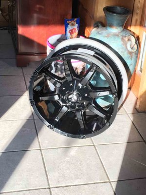

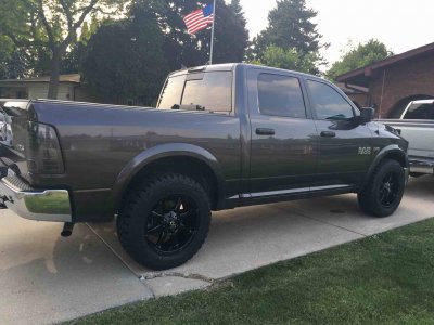

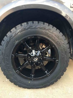

Just had fuel coupler black gloss 20x9 +1 offset on 275/65/20 Toyo R/T tires on a stock setup! That comes out to 34.1x11 on the tire. No rub in any direction.
I've only driven 10 miles home on them and so far I think the truck rides a bit more composed than the stock setup on SRA's. Seems to go over the bumps more smoothly.
I notice a little bit less agility and acceleration as expected from a 44 lb rim and a 62 lb tire. There is some noticeable road noise but not crazy loud just a slight hum. I have a 2014 5.7 with 3.92 gears and an 8speed. I can report changes in economy as I'm taking a 2 hour trip back and forth this weekend on the highway. I know the computer will be off for mpg.. But is the error in the speedo going to give me better or worse readings? I'm not sure of any way to make up for that in my calculation if I don't use a full tank.

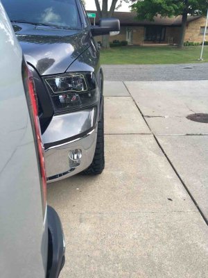

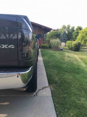

As you can see the tires give a slightly wider stance but they still fit under the stock fender flares.

Congrats on the upgrade man. They look good and suit the truck.

Nice truck, wheels look sweet. Is that the OutDoorsman package?
