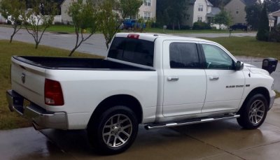

Although I still have a rake on mine, this is the Bils at 2.1 and I have a 2 inch spacer in the rear. I do plan on running bigger tires, most likely some 35 but I will be keeping the stock rims. Hope this helps

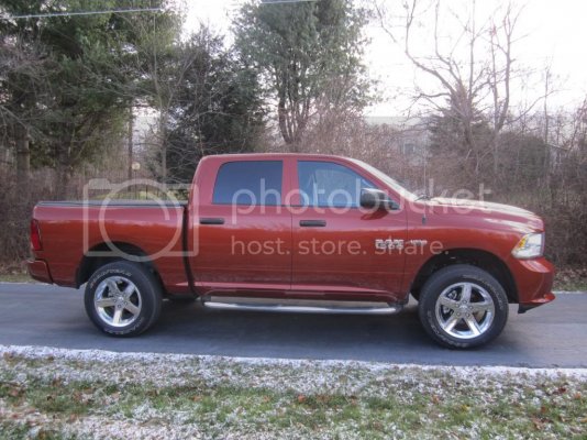

Well I'm leveled via a 2.5" kit as opposed to Bilsteins. I'm also on factory 20" wheels and stock tire size. I don't off-road nor do I carry any loads so there really in my situation any need to raise the rear any. Although I wanted to grab a set of Bilstein based on others experience, I know that what I really want just looks wise is a 6" lift. Will be doing that in 2016 after I do the revamp on my SQ car.
