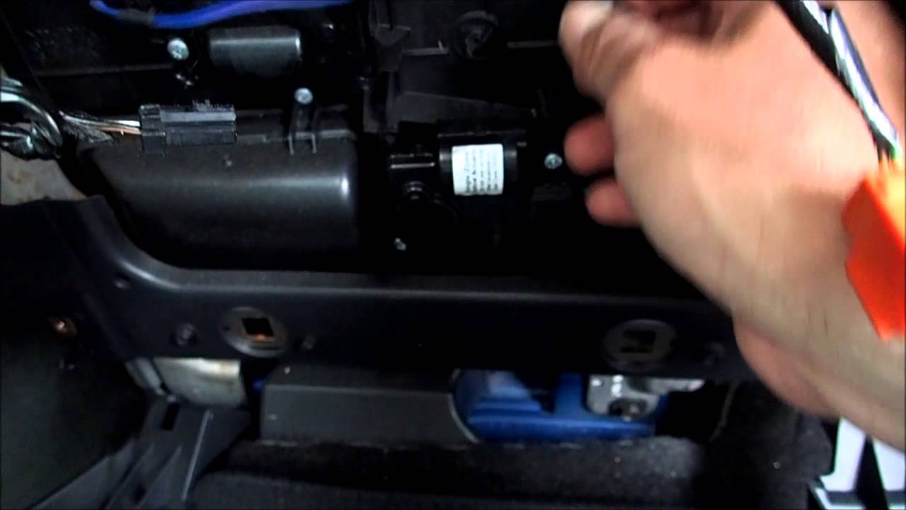

Have 4 Actuators & they are easy to get to them, ( some have 5 & the 5th one requires removing the whole HVAC Box )
Removing the Glove Compartments, allows you to see & check out 2 of the actuators
#1 is straight up above the Fan
#2 is sort of to the left of the fan
You can watch them moving, by working the HVAC Controls
If you remove the 2 screws holding the actuators in place, you can remove them and work the short lever that actually moves the door inside the box, you can feel & hear the door move when you remove the lever, if it does not seem to move the door, then the door is broken.
The other 2 actuators are hidden behind the Radio Bezel & maybe the cup holder if you have that type seat console
Unscrew the radio bezel & let it lay back toward the seat.
You may be able to see the actuators move, if not, you may have to disconnect any wires that are restricting your view
