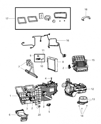

- Next step(s)? Replace the other actuators? If so, how many others are there?

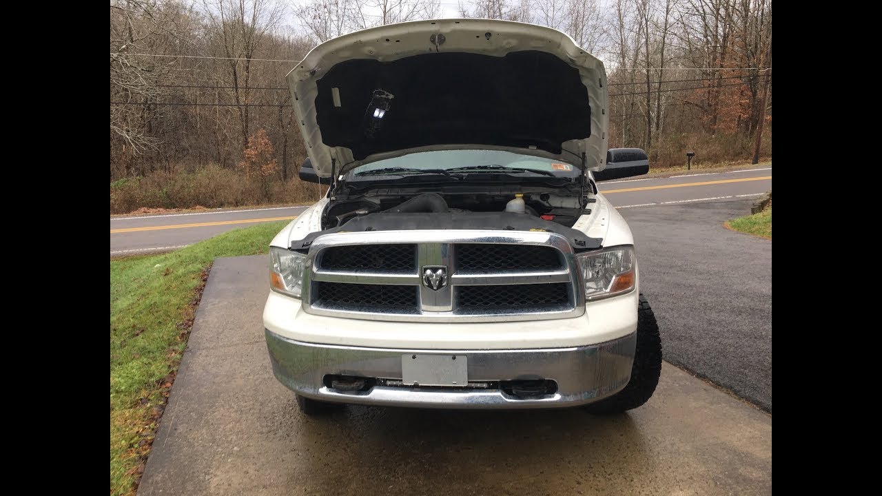

Dodge Ram Heater Core Flush
My 2009 Dodge Ram has been blowing warmish air for a few weeks now. This video I'll be flushing the heater core in attempt to restore maximum heat. I also wi...
