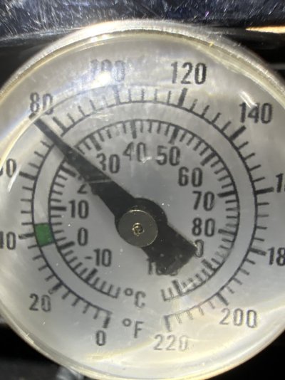

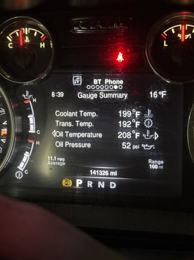

I have flushed my coolant system, CLR’d my heater core, changed my thermostat and still no heat in cab warmest it blows out of my dash is 80 degrees what am I doing wrong ? 2016 Ram 3500 6.7

Make sure you burp the system get all of the air out of the heater core. If you check the blend doors and they all check out then... Its heater core replacement time It is a big job but not the end of the world it can be done in 1 day.

Yeah, heater core is the highest point so first to lose coolant and I imagine first to take on air if it's in the system. For whatever reason these trucks can be difficult to get all the air out.
Curious - any difference in temp between driver's side and passenger side? If so, I'd lean towards heater core still clogged. Also, did this just come on one day or gradual?

It's almost always your heater core, if flushing didn't work your going to need to replace it. I've seen it 1000 times.
With that said, it looks like you have some sort of aftermarket head unit? Are you sure that is controller the HVAC system correctly? I'd be a little suspect of some aftermarket chinese head unit and it's ability to integrate with the system properly.
