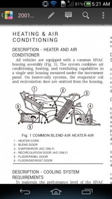

probably blend door they are bad about breaking the output on it.. search for heater treater dodge ram.. this may be of help and the blend door is under the dash to the right of trans tunnel
