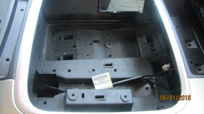

Can anyone tell me if there is a factory connection under the driver seat of a 2015 Laramie Crew cab that provides power to the 12 volt outlets and the rear center console?
The body shop had the driver seat out and now neither have power. I checked all fuses at the panel. No luck.

It may be the group of harnesses under the driver seat nearest the center console. There are several there easily checked.
GTyankee
Nov 2, 2020
12,391
17,460
El Cajon Calif. 92021
3.0 ecodiesel
there are wires under which ever center section you have
Do you have a power unit fastened to the passenger seat frame , just under the seat cushion?
That supplies 115 VAC to your dashboard power plug
