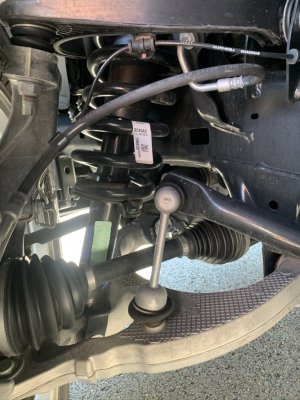

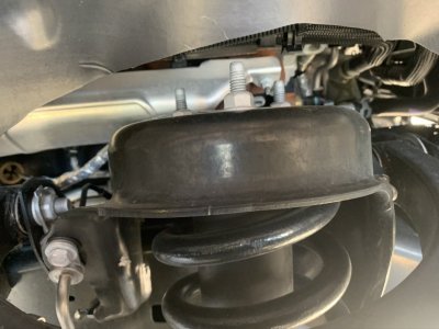

I have not had a North Edition at my shop yet but I would think it’s similar to the warlock that came with the factory 1”. Can you post a couple front end suspension pictures

Let me know if you need a better angle.. I’ll have to take the fender well off in the back if you need a better angle on it

you can do any leveling kit you’d like. There is nothing special as I suspected it’s the same set up as the warlocks 1” higher than factory.
