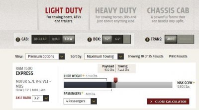

OK, so to those that have followed my post about finding out some info on my towing capabilities, and my visit Saturday night to the RV show in Pittsburgh, I "think" I know what to start looking for.
So, basically, the Ram Trucks towing website (screen shot attached) says this.
Running 3.21 gears, 4 passengers, saving 500 lbs of reserve payload for the truck, my max towing is 7,448 lbs.
So, I am looking for either a Toy Hauler or Travel Trailer that has a GVWR of @ 6,700 lbs, saving 10% or so off the total.
So - would it be safe to say that anything in the 6,500 - 7,000 range would most likely work out?
Any suggestions - would like to sleep 4 comfortably if possible. 2 adults, 2 kids.

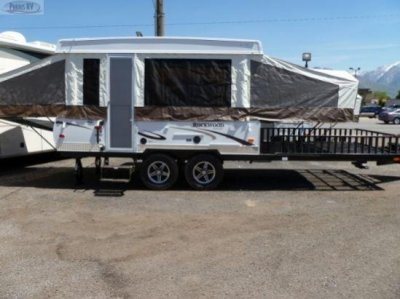

They also make pop-ups that are like toy haulers. Basicily they extend the frame and it gives you an area to haul your stuff. These are super light, and cheaper. It also would give you a bigger living space once you arive at your destination.

I don't know anything about toy haulers, but wanted to make sure you're taking the weight of the quads into account if they're going to be on the trailer? If they're on the front area like the popup above, if could seriously jeopardize your payload and tongue weight. Actually, doing that AND putting a quad and/or bike in the bed will kill your max's.
Every toy hauler I've seen has a "garage" area in the back, that is where you out the quads. I haven't seen one with the garage in the front.
