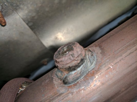

Well I found the reason for my P0037 and P0138 bank 1 sensor 2 O2 codes...pictures should tell the story here...
Now, what the hell am I supposed to do with this?!

Isn't that just a sensor plug? Are the threads still good? Is it an aftermarket exhaust setup?

My guess is someone had a bad sensor, found out they cost about $60 and just eliminated it. If the wire harness is still around, just put a new sensor in and plug it in.
Yes I believe it's aftermarket exhaust
The sensor won't fit down into the hole so I got to get that top part off I believe.
