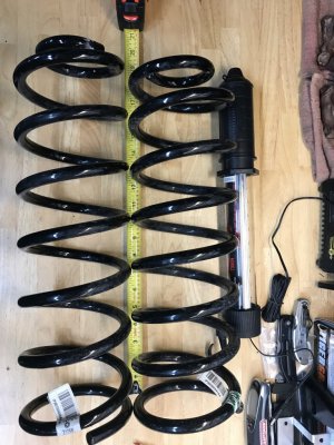

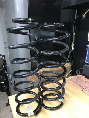

While straightening up around the garage today I had my oem rear coil springs together and noticed one of them is about 1/2” longer than the other. I had my lift installed by a shop so I have no idea what coil was on what side.
For you guys that are doing lifts, replacing rear coils or adding spacers, could you please do them one side at a time and write down the part number with it’s corresponding side and post that info here?
2017 CrewCab Hemi 8sp 5’bed 4x4
My part numbers are:
  • 05154649AA (18-3/4”)
  • 68307041AA (18-1/4”)
For the record I didn’t have any lean as I’ve heard others having, my dims before lifting were within 1/8-1/4 of each other side x side

Wish I knew which one was on what side lol
Was the longer coil on the pass side to offset for the weight on the drivers side fast tank?
or
Was the longer coil on the drivers side due to the extra fuel weight?

I don't have any of the factory stuff as i threw everything away, but i'm sure my rear springs were the same size, are you sure the shop didn't mix your coils by mistake ?

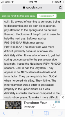

Here’s a few comments from other forums talking about it too

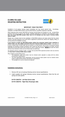

Thanks, we’re your Eibach rear coils side specific?
Looking at the new Bilstein rear coils and they are side specific
