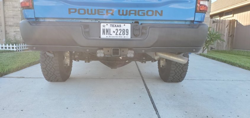

I mounted here

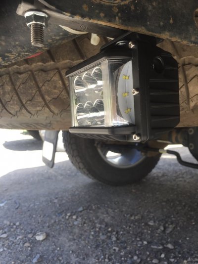

I have two side shooters under my bumper attached to my receiver with 2&3/4” muffler clamps. Works awesome

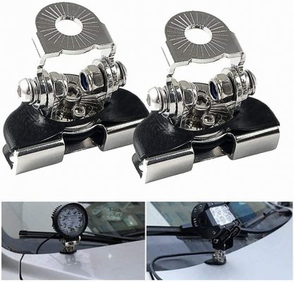

These brackets or something similar give you a little more flexibility than the muffler clamps (I've tried both). They can be mounted at more locations on the bumper. Only issue I've found is that one loosened up on me, I guess from vibration after 1k or more miles. A set screw backed out but I found a replacement at Ace Hardware. More expensive than clamps but relatively in expensive. After some thought, if and when I do replace them I may go with something with more quality, after all most of us are hanging very expensive lights off them. I've also seen some members cut their bumpers to flush mount lights, very cool but beyond my skill level to do well.
Amazon link:
