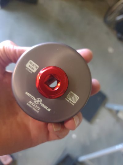

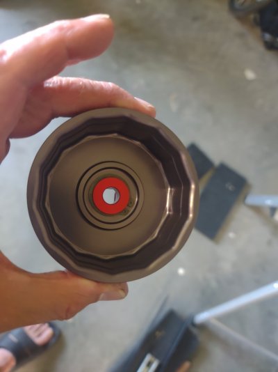

I bought a 74/76mm -14 flute cap wrench and it wouldn't fit, even though I test fit it at the autoparts store.
I tried a strap wrench, like the one's I grew up with and had very limited access. It just dented the filter. I've got a Torklift front receiver and access is a b*tch. I could hardly lay a glove on it and it still wouldn't budge.
My inner carpenter said, "get the hammer" and which I did.
My brand new truck! A few taps with my framing hammer I got the the wrench to seat. Using a 3/8" ratchet the rest was easy.

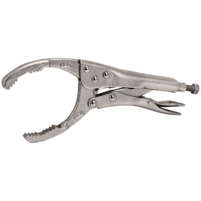

RAM should include this oil filter wrench from Harbor Freight with every new truck from the factory- best $10 tool ever. I had the same hammer issues on my first oil change. 6C51BD22-3EA5-4D17-A313-503864AB31CD.jpeg

How the fudge do you get that chungus in there??? I have enough trouble with my strap style wrench, which has a handle I can turn ~90 degrees!

Nice, That's all I use as well. Make's removal a breeze.

what 5.7 hemi filters will it fit..
