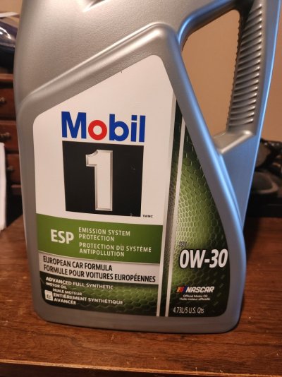

Going to try out the Mobil 1 ESP 0w30 for my next oil change in my 5.7 hemi. I will also be adding a 15oz bottle of lubegard to add some more moly and use the royal purple 20-820 filter like I always use. I've been using schaeffers supreme 9000 5w30 for awhile and been happy with it but it's getting expensive and having to always pay for shipping is getting old. I want to switch to something i can grab off the shelf at the store.The Mobil 1 esp 0w30 comes highly recommended by Burla and Travis8352.

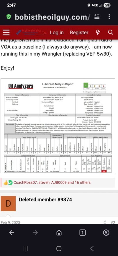

I don't recall what that has for Moly additive - you might look on BITOG for a VOA, or maybe someone put one here in the BLACSTONE thread.

I believe Travis8352 said the Mobil 1 esp 0w30 has around 80 for moly,is that what u were asking?
I have zero short term memory, so that.
But I do know we estimated a minimum Mo level of 250 ppm is required to have maximum impact on lifter roller wear reduction. I won't get into that assessment again here, but brands like Red Line and HPL go way overkill on Mo to ensure no issues.
So yes, if you know Mobil 1 ESP 0W-30 is 80 ppm Moly, I would concur to add LubeGard Moly supplement. I'm using expensive HPL SuperCar 0W-30 in my Hemi 6.4, and Mobil 1 ESP 0W-30 in my GDI turbo motors.

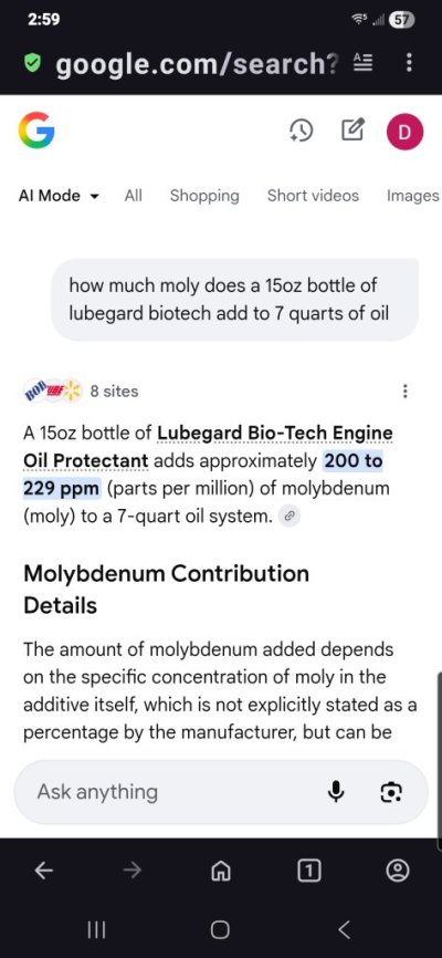

That's why I liked schaeffers, it has alot of moly in it. Im not sure how much moly a 15oz bottle of the lubegard will add to the say 70 or 80 ppm of moly already in the Mobil 1 ESP 0w30?
