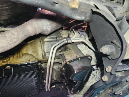

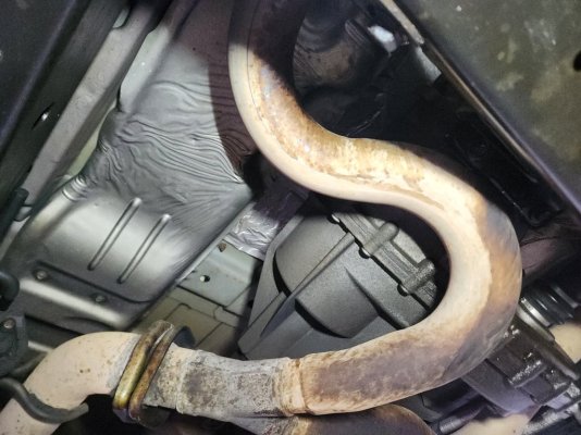

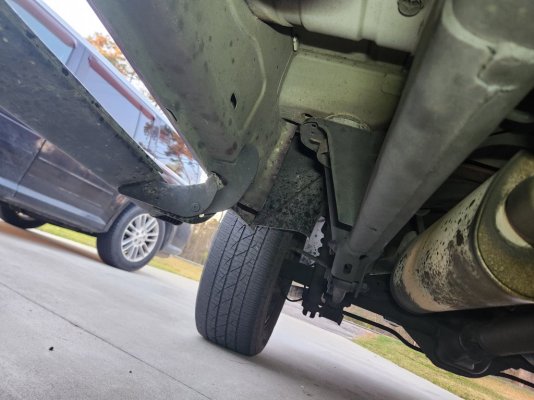

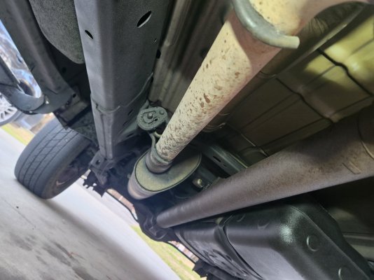

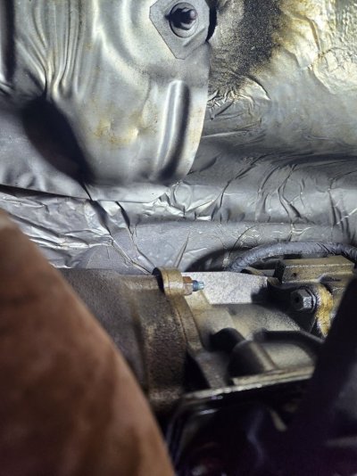

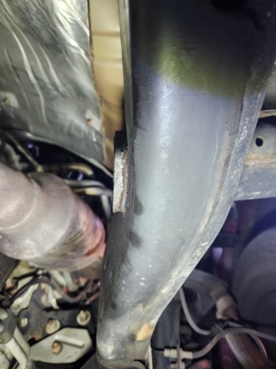

Sorry yall, was in the hospital and in recovery for a while. I sprayed the undercarriage with degreaser and washed it today. Drove about 4 hours today. And this is what it looks like. Im thinking rear main seal. Just curious of anyone else has suggestions. Also, the oil filter housing is still dry and clean after replacing last year.

Checked with flashlight and mirror first. Then I took off the intake plenum and lower intake manifold..

Looks to me like it is running down the sides of your trans which means it is coming from above, like the oil cooler.
If it was your rear main seal it would be dripping out the bottom of the trans bell housing where it meets the engine.
