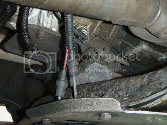

Sounds like the vacuum lines are reversed at the transfer case. There is a pair of vacuum lines going from the front axle to the transfer case. They should be red and black. switch them at the transfer case and should be good.

No problem. That's at least what it sounds like. I did the same thing on my truck once. Also check the shift linkage while it is up there. One thing I would recommend is changing out the vacuum connectors that go from the hard lines to the red and black lines at the transfer case. Truck004.jpg
These will loose their connection over time and make vacuum leaks. I used a 2" piece of rubber vacuum line to fix mine.
