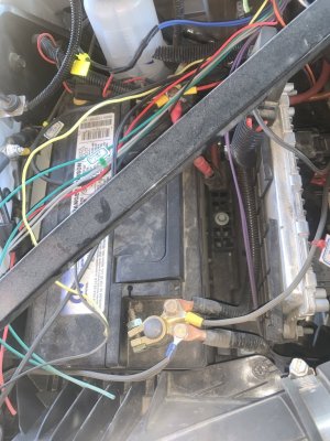

Thanks. It sounds like they may have used a dual battery tray from a Cummins. Would it be possible to take a picture of the second battery mounting and post it here. I am going to order a second battery tray and see if it works.

Still working on cleaning up the wire runs. After I get the spot and flood lights purchased and installed I will be able to make it all a bit more permanent. Most of those colored wires in the picture are for the lights and the Switch-Pros system.
