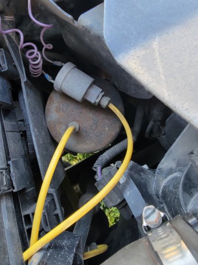

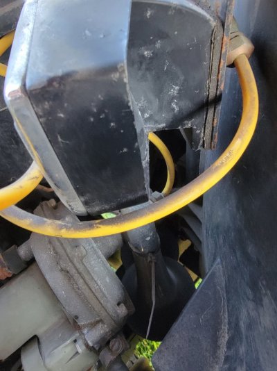

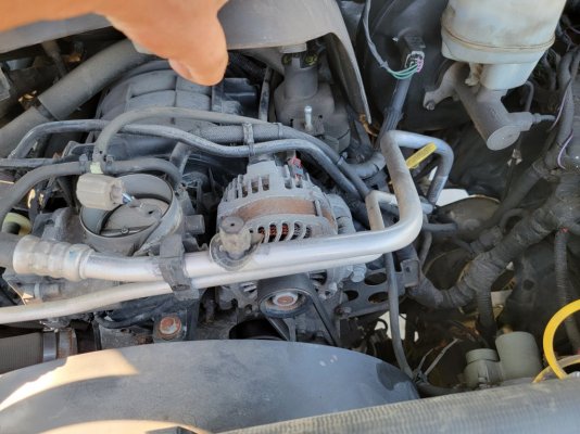

Ahhh, makes perfect sense! Found something even crazier today as I was checking some things. Found a old Ford Vacuum powered air horn under the hood. Still trying to get it to work lol.
could the air horn air pump be used to inflate the shock ones? just thinking out loud here...lol...that is if the air horns don't work.
