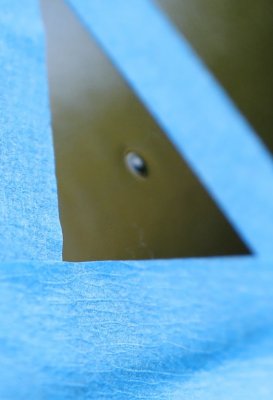

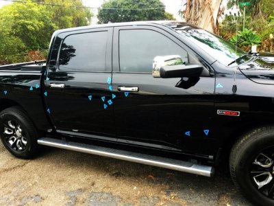

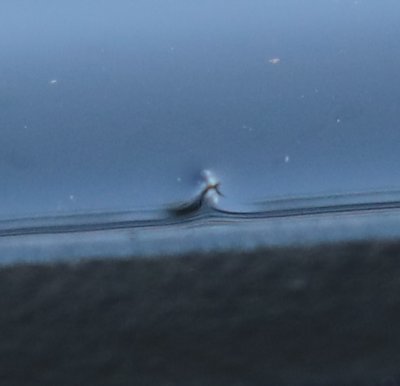

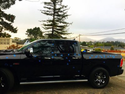

Hi everyone! I have a 2015 Ecodiesel Limited in Black
I got it a few weeks ago and then after getting it home I went to do a nice wash and detail of the car and found nibs and bumps all over the vehicle.
They are small some the size of a grain of sand and some up to like 2mm but are definitely from the factory and under/in the paint.
The dicey part is that this truck has more than 36k miles so it is no longer in the 36/36 warranty. The previous owner who was a 92 woman paid lots of money for a 7yr/100mi max care warranty but unfortunately it doesnt cover paint.
A few of these bumps have a crack in them and show the signs of rust on the edges of the crack.
After closely examining the truck and taping off all the defects, I counted 86!!! on a $60k msrp truck?!!! and Im sure there are more if I spend more time looking. They are on every panel except the bumper(I have matching paint bumper not chrome), which after a little bit of research I found out is painted in a totally different location. My truck was painted in the Warren factory.
I recently took it to a dealership and expressed my frustration as it was such a horrible paint job. He seems to be on my side and is helping me make a claim with Mopar care. The vehicle is in warranty period for the rust warranty which is 5yr, unlimited mileage. He asked for me to get an estimate from a local paint shop on a complete repaint.
I plan on dropping off this estimate tomorrow but I wanted to reach out and see if anyone else had issues with paint on most of their panels and what the resolution was. The paint guys (went to 3 shops) all expressed that painting a truck properly is a pain in the ass as you will have to get all lights, decals, etc off the truck and remove the bed as well to paint all areas including doors for the jams. They mentioned that getting proper fitting after is difficult and that this model truck will likely look the best if I can find a different one that comes out done well from the factory.
I doubt they will replace my truck because of this but after I saw my estimate maybe it would be a better economical option if mopar's cost on a truck is lower.
Does anyone know what the actual build cost is of a ecodiesel truck?
Would love to hear from anyone with this kind of warranty issue and what the resolution was, Thanks.

Those seem to be fairly large defects. Are you sure the truck didn't have body work at some point?

I have one bad one. Mines under the hood. gonna get it fixed just so it doesn't rust. Non the less it's not something you wanna see when you spend that kind of money. Yours seems to be a lot worse. Hope the dealer does something f4c65ae13bc5ec6e50306a8029818f74.jpg

Wow that is terrible. My truck only has only one. Your truck is unacceptable. I feel like even ram wouldn't have released this truck like this I feel like it was repainted without an insurance claim that's real amateur work

There have been complaints about the paint work at the Warren Plant for years. Some bad paint jobs and some even worse. Yours in one of the worst I've seen. IMHO if you find a GOOD PROFESSIONAL painter, he can give you a better complete paint job than any factory paint job. Realignment of the body panels should be able to be done by most competent body men. Please realize that this is by no means a simple or cheap process. A complete paint job nowadays can run 5k or more----depending on the paint it can be a lot more.

As others have said "wow"!! I can see that repair costing big money. I would think it would need a full body paint job because I can't imagine them being able to make that many small repairs without having the paint look "uneven". Tell us how it works out.

My 2016 Rebel has a few and my 2014 Sport also had a few. The paint job on the trucks from the Warren plant are terrible and have been complained about for years. On my black 2014 Sport I had 3 of my 4 doors without black paint on the bottom....just clear coated. I had it repainted under warranty.

To everyone curious about if it is original factory paint: Yes it is 100% factory paint.

As for the paint clearly I agree with everyone it is BAD!

To HS Custom: That looks similar to the spots that are on the outside of my truck. I wish mine was just under the hood!

I've found about 8 total on my 2018 black out edition. They are going to fix them when they repaint my tailgate, which has a faint purple streak running across the top of it. Guess what? Warren plant too!

My 2013 Ram 1500 was built at the Warren Plant. It developed a few of these on the body after purchase, as well as had the paint flake off only a month after purchase. I took it in, initially the paint was denied but then they accepted it and painted a few sections of the truck.
There was a guy on here who was going through this with me at the same time. He had to have entire body panels repainted. It also required some representative to come and inspect the truck before approval. It was no easy task.
With my 2013, they repainted the sections and they matched fine with no noticeable issues afterwards. This will be no easy task to get Ram to correct.
