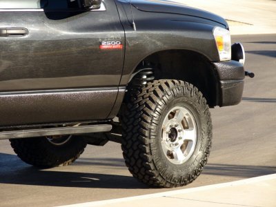

Totally agree. I've actually painted both color codes. The Brilliant Black will look gray next to your black truck.
It's not the best picture, but here is my Brilliant Black 2008 truck. You can see how much flake is in there and how gray it looks. It was nice at night, looked black.
