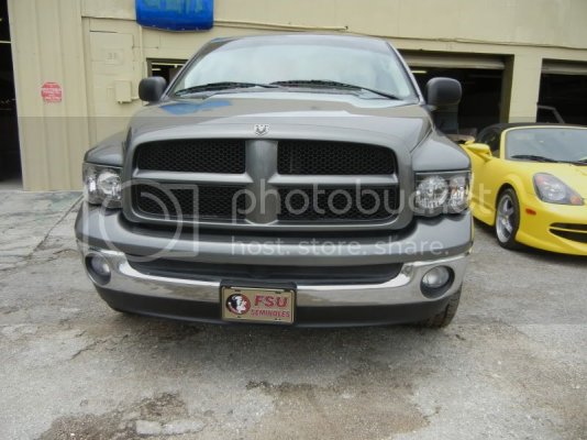

I had mine done by a painter...was about $100
Before:
After:
Mine was also chrome, make sure you really put some work into your prep, especially when using aerosol.
