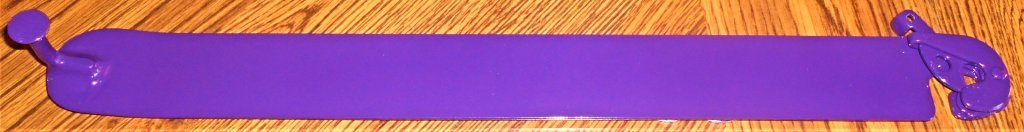

I've got a couple homemade hood props that push in and latch on the hood latch,they've always worked for me.
This ones for the wifes old Challenger,as i'm to lazy to go get a pic of the one for the truck,it's the same thing anyways,just a differant colour ;)
