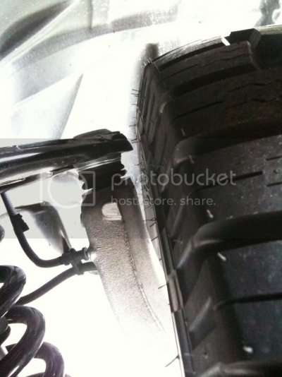

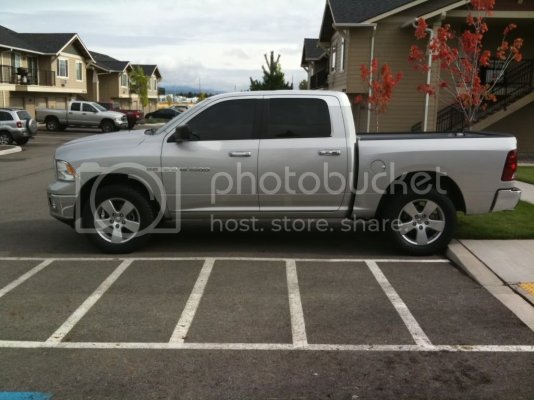

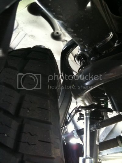

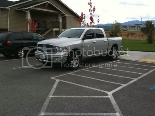

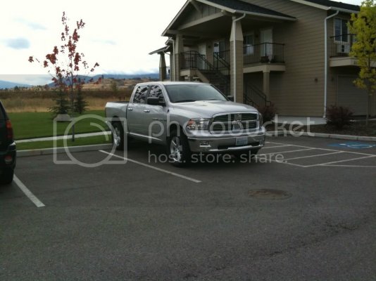

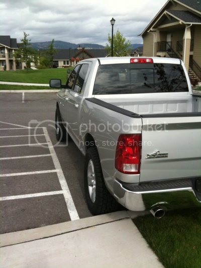

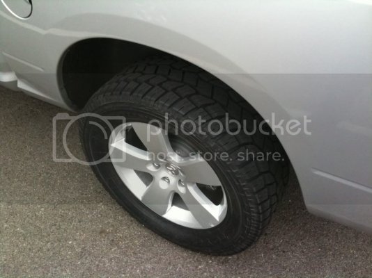

thought i'd share some pics. added a Top Gun Customz 1.5" leveling kit and 305/55/20 Toyo Open Country A/T's.
driver's side clearance with UCA, tires pointing straight:
passenger's side clearance with sway bar, tires cranked left towards sway bar:

dang man that's looking real good. what is the difference in speed with the 305/55/20's on and is there any rubbing because ive been looking for some new tires

sweet!! also good to see that you fit 305's with no rubbing
thanks man, the heavier weight of these tires is noticeable at take off but the hemi has more than enough power to move them. the OEM Goodyears weigh 42lbs and these Toyo's weigh 56.9lbs, which is pretty light for a 305/55/20 10-ply tire.
as far as rubbing goes, i'm almost positive that the reason i'm able to clear them with the UCA is because my stock wheels are 20x8x19.05mm. i believe them being 8" (opposed to the 9" wide chrome clads) is what allows me to fit these without wheel spacers.
oh.....i figured those wheels were 20x9 also.
