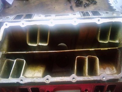

So having the day off I started to replace the intake gasket's, plugs, wires, cap and rotor. I wanted to put my MSD 6a on it also but could not find a diagram so I skipped it for now. I dont think this is the first time the gaskets have been replaced, the tube and a half of orange silicon was my first hint, FelPro gaskets was my second. I did not get the Hueghs kit, too much money on an engine with 204K miles on it. Hopefully the next time I pull it apart it will be for a rebuild and new intake!
I did mod the kegger as listed on the DIY and took a few pics for you guys. Sorry for the glare I took them on my workbench with a huge window in front of it for light, kinda back fired for pics LOL.

you should paint if while you have it off :p I think you'll be glad you did the keggar. heard it adds to the low end.

Must be nice to make that kinda money. I made $80 w/o over time, so my time isn't worth as much. As far as not being much use, I just finished it yesterday and did not put the MSD box or coil on and have noticed a good change in low end torque. Now some of that will be due to the vacuum leak also but the actual modding of the kegger only took me about 2 hours. The materials, well ball peen hammer <owned> 3 1/2" grinder <owned>, air dremal with stone <owned but ruined the stone being its alum> and two hours time.
<shrugs> To each his own but I put it back together stock to see if there was a diff and I did notice, now I don't have use of a dyno any more or I would have got the numbers for you guys. But I'd say it was worth 5 hp and a few foot pnds of torque, may not seem like much but it's "free" power and I did not want to spend the $500 on a new intake w/o rebuilding the lower end.
