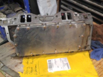

Maybe change the “beer keg” intake gasket out for the Hughes intake kit, which replaces that thin steel pan with a thicker aluminum plate.
Or look at Hughes’ AirGap intake, which seals the whole component.

Get the dorman gasket set toss the therostat they stay open and get longer plenum bolts grade 8 with locktite.
Done rite your truck will come back to life if it hasnt already clogged your cat

Misfire on 8 yep sure sign .guy on ebay makes the best water jet cut aluminum 1/4 plate to fix plenum .

5.9
Go with the full thick aluminium plate with grade 8bolts and the dorman gasket kit.guy on ebay out of canada cuts the best perfect fit plate.includes the bolts.best thing i did for my engine.wish i did it before i had to gut my cats..North Idaho has no emissions lucky me ...brought all the horsepower back!!!

Is this manifold plate still available from Ebay? A Canadian vendor on Ebay?
Bonus question: What is the best gasket to use (which is regardless if I'm re-using the original steel pan or aftermarket aluminum pan - that shouldn't matter right) ?
The Felpro is supposed to be the best I read, but is it metal re-inforced? Is there a metal-reinforced gasket for this?

5.9
Mancini Racing (800-843-2821) has a GREAT repair kit for this! It's a 1/4" aluminum plate with all required hardware and realy nice gasket. The gasket I used when I did mine in my old engine was just a cheap cardboard thing. Thankfully I don't have to worry about this gasket anymore as the crate engine I swapped in has the M1 single plane "tarantula" style intake.
