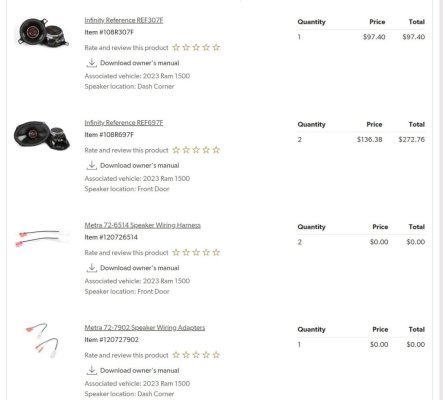

Not sure if the 2500 base system is the same as the 1500, but this is what I went with. So far I've installed the 2X dash 3.5" and 2X 6X9 in the front doors. It was getting hot and I was getting sore from tugging on the door panels, so planning to do the rear doors this weekend. Crutchfield recommended only 3ohm speakers since there isn't an amp for the base system in the 1500.
