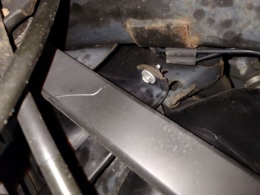

Morning everyone,
Does anyone have a picture of the outside rear mount point for the fuel tank skid plate on a 4th gen power wagon?
I know all the other skid plates are direct bolt on to any ram 2500, but I would like to verify the fuel tank skid plate mounting points before attempting to install it. Just a note I already have the crossmember under the fuel tank to mount the front portion of the tank protection.

where the rear metal strap is around the tank. look straight up to the center crossmember and it should be empty bolt holes

Thanks.. That confirms what I was already thinking. Not all 2500's have the outer rear mounting point for the fuel tank skid plate. My 2018 model only has the strap hook point and not the bolt mounting point for the skid plate.
