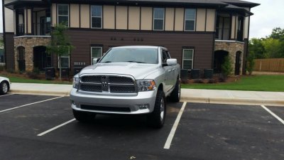

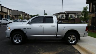

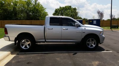

Installed front and rear pro runners today and absolutely love the feel for these. I gained a little over 3 before settling and I had a 1.5" rear spacer in the springs. Also installed hub/wheel centric wheel spacers. Next up is zone BL and JBA headers

Andrew09, how do you like the ride and handleing?, trying to make up my mind between the Pro Comp and bilstein. Truck looks nice.

The spacers are off eBay, I'll get the link. I went with them cause there are a few other members using them for some time with no issues, 157 shipped.
I love the ride, I was driving around with a rear spring spacer so the rear would bounce around like crazy and with 87k miles it was due for an upgrade. I have 0 complaints with this set up and with the $80 rebate card, I paid $280 for fronts and rears

Looks good man! I have the same truck in 13 and I am getting ready to but bils on front with zone Ucas, and bils in back with new Ssc-50 super coils in the rear, they give a 3/4 in lift and 450 lbs more capacity over the stock coils. I am also adding the 1.5" zone BL as well. With post a thread and pics soon.:favorites13:

I just got my procomp pro runners in the mail. Gonna be pairing that with a .75 rear spacer and i also got the 1.25 rough country body lift. Now just waiting on my 35 mt tires to arrive with my rims. What size tires did you go with. Your truck looks awesome man

I had 35x12.50s **** cepek radials on when I bought it so I'm using them for now good tire quiet. Also the truck came with a spacer lift installed in rear not in front so had a huge rake for awhile I'd like to be on coils on the rear but I don't tow anything so this will work for now.
I'm glad I went procomp to be honest, never had good results with bilstein on lifted jeeps so I'm happy with them. Thanks for compliments, truck is a whole new animal
