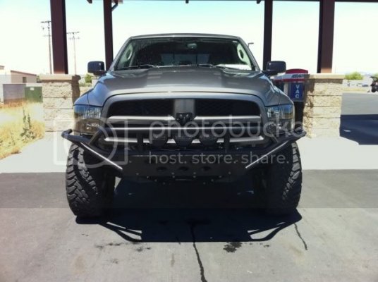

The pics of that truck are really what sold me since he doesn't have the flares either lol, I love the look.
I think I may end up going without flares because to fill the kore fenders i'd need a pretty negative offset. I've been using this tire chart to figure out offsets etc.

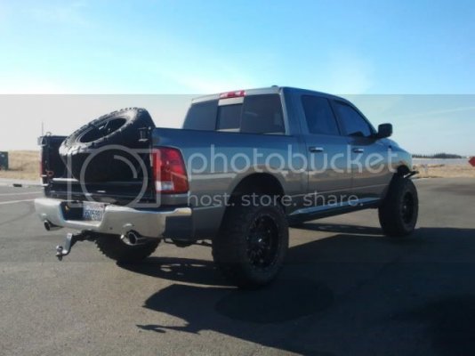

Those wheels look like 20x10, 24 offset to me as they stick out as far as mine.
Those also look like 37's.
but tires can be deceiving based on lift.
So he either has a 4" lift and 35'a or 6" lift and 37's
Unless he has the KORE suspension which I doubt.
Like I said i've never had aftermarket wheels so offsets and everything like that are new to me lol.
If I remember correctly, he has a 6inch lift with 37s. Definitely not Kore though. I'd like to go with ideally a 17 inch rim so I can have a meaty side wall for off the roads, but finding a nice offset is the hard part. 18s would be easier.
