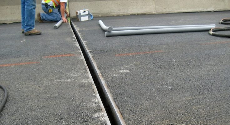

@Vandy321 I am wrong, you are talking about something like this ?
Road I drive on, has in some areas like below picture.
Also in other areas, it has small strip of metal between different sections of concrete.

Perhaps, you are using the incorrect term for what you are trying to describe
An Expansion Joint is used on bridges
Bridge expansion joints are designed to adjust its length accommodating movement or deformation by external loads, shrinkage, or temperature variations, and allow for continuous traffic between bridge structures and interconnecting structures (another bridge or abutment).
What you may be trying to describe is what happens to concrete slabs over a period of time.
Heavy vehicles like loaded semi trucks drive down the highway & whether we realize it or not, they set up a bouncing motion.
That motion when combined with rain going down in between the concrete slabs causes mud, for lack of a better word.
The truck comes along & pounds on the beginning of the concrete slab, pushing it down. meanwhile at the far end of the slab, a bit of gravel slides under the temporarily lifted slab, , each time something heavy drives over that slab over a period of years.
Over time, the leading edge of each slab pushes down & the far end of the slab lifts.
At some point, usually during the night, a construction company will come in & try to grind the concrete slabs back to level again.
We had a highway that got so bad that they actually slowed the speed limit temporarily, until they could let out bids to do the grinding
Nothing but slowing down will make your ride smoother, in that situation

They are called expansion joints or control joints, but nothing to do with Bridge.
Sometimes it's just line with saw. Some newer roads, where I live. They also add a filler one certain roads.
Metal joint I was babbling about, is for bridge/overpass though. But not what Vandy is talking about.

That is not solid ground under the area shown in the image, that is the beginning of a bridge or large culvert
In 33 years of working on highways, we never shoved rubber tubing between concrete slabs on compacted soil or asphalt.
Usually when a concrete highway is laid, there are no joints. After the concrete dries they Saw Cut the joints
Yes, they could very well be cut, or poured that way... It's the same cracks you would put in a garage or driveway slab at specified intervals to prevent actual cracking of ths slab.
Also correct, that pic appears to be of a bridge, that is not the same joint I'm talking about. the article is what I was referencing, not the pic.
