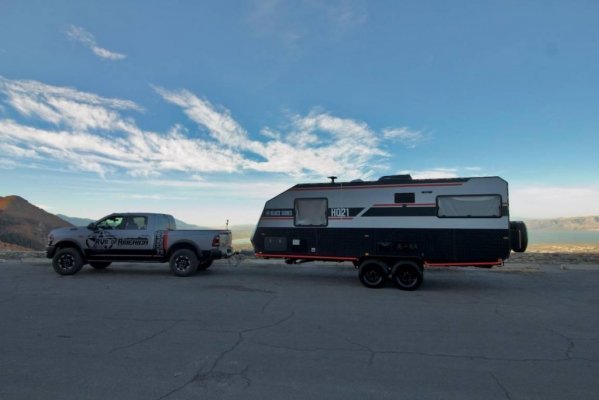

Our large dogs are the main issue in the cold. Have to keep the rear bunk tent area on our Starcraft 15RB AR-1 Extreme down for their sleeping area which means the furnace runs the majority of the night on 158 Amp hours of AGM batteries.
Currently get around 8 MPG towing in tow mode in cold temperatures and its more than twice as light as the Black Series HQ21 that we really need.
Photo shown below is from Black Series HQ21 dealership...
Need the winter package on it, but it's still too cold for winter water usage. My bet is that at 7,480 pounds dry weight my gas mileage will suffer with the Black Series. So no ECO mode. Long stretches of no gas between our home and the Moab region via Gateway with 10% grades. Had to go out of the way to fill up in Naturita, Colorado after Moab today due to we visited the Anticline Overlook. Approximately 70% of the few gas pumps working at the 2 stations in Naturita, the rest are in quite poor shape with all of the credit card readers entirely beaten, destroyed, and taped over.

Nice setup!
I have towed an 8000 pound travel trailer around with my power wagon for 5 summers…never seen more than 9 mpg…usually a little less.
