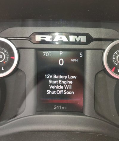

Question about a battery message 2026 1500 Big Horn 5.7 Etorqe with 241 miles on it. I'm new to the 5th gens, have had all the generation before it.
I got this message. jumped into the truck to connect cell phone, so I just turned it on, not to start. got the message 12V battery low start engine vehicle will shut of soon. I've seen this a couple of times.
is this a problem or informational? if problem, then what does it indicate? if informational, what does that indicate?
thanks

All below IMHO only:
Your vehicle is in battery saver mode, indicating a low charge on the 12V Battery.
Is your battery light on???
Indicates low battery, battery charge system issue: Could also be a problem with a bad start/stop battery. U have (2) batteries under the hood:
The main 12V and another smaller battery directly logged into the start/stop system: It has been reported that when the smaller
stop/start battery bad, it will drain the 12V battery also.
You need to get vehicle into Dealership now: There have also been reports that a software patch is needed ref batteries/charging system.::

The OP has the etorque 5.7 Hemi, not the 3.0 Hurricane. I wouldn't assume the section of 2025 owner's manual would apply to his 2026 because the Hemi wasn't even available for 2025. Unless Ram changed the Hemi etorque system for 2026 models, there's only one battery under the hood. The 48v etorque battery module is mounted to the rear wall of the cab, on the driver's side.
@IAshooter...the etorque mgu charges the battery in the 48v battery module, which in turn charges the main 12v battery. If your 12v battery isn't getting sufficiently charged you could have an issue with the 12v battery, the MGU, or the 48v battery module. If the 12v battery isn't holding a charge there could be a system that's draining the battery when the truck is shut off. There are too many variables involved to be able to point you in a specific direction. It's a brand new truck. I'd make an appointment with your dealership and let them diagnose it.

Dang it. Just saw 25/26 thought hurricane. Argh. But still good info for hurricane owners so not gonna delete.
If he is getting a 12v battery low still sumthin going on. Could be as simple as a loose cable, bad battery, software issue, MGU issues. Hopefully just battery or software issue.
I can’t talk much on E junkola specifically since have a straight no E junk in my 2019.
Of course OPs 26 has that new Atlantic electronics so who knows there either.
Which is even more of a reason to have a dealership look at it IMO.

OP: that error is listed in your manual as : Auto Key Off mode. U need to download manual, research and also get vehicle into dealership tell them the screen error and vehicle going into: Auto Key Off mode. They still gonna have to figure out why battery not sufficiently charged or being charged.

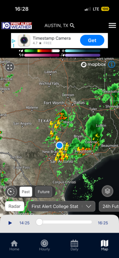

Found it see post #7. On phone so cannot paste in. Big T storms so PC off.

Ya, got an appointment with the dealership for the 25th. I'm turkey hunting starting tomorrow. Shooting a turkey in the face is my priority now.
Got a nearly new spare 12V in the bed of my truck just in case.
